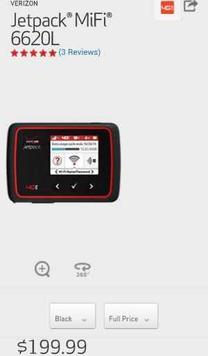

The newest Jetpack MiFi 6620l takes a nano sim.
