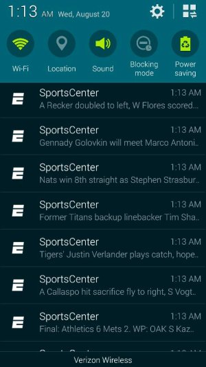

The phone operates as normal as does the wifi, as long as I am doing something requiring it to be in use. Facebook app, browsing web etc. Once I am done with whatever I am doing and lay the phone down, the screen timeout kicks in like it normally does and I assume all is well. Give it 30-40 minutes and when I pick the phone back up and as soon as I use the data again, I will get a flood of ESPN app alerts all of them with the exact same, and current, time stamp, they are also old events such as scoring play in a game or end of game final score which happened already in real time, sometimes quite a while ago. Gmail notifications pop up saying I have new mail, Facebook app notifications show up as well as the Facebook app icon on home screen updating to show alerts pending.

Bet you couldn't guess that I fell asleep and woke up to check my phone at 1:13am.
