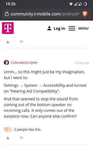

After the update to android 11 opera phone calls are always on speaker and cant be turned off.
Weird glitch that I didn't notice right away because I usually have an earbud.
I have an unbranded 7pro although I am on Tmobile.
Going to try this...Thank you!
Yep I had the same problem. Same fix worked. I'm really getting more disappointed with this update by the day. I'm about to add a new line and I've been looking at the 8T since it came out and I'll probably make it my daily driver and finally root the 7 Pro just so I can roll back. Even the minor devs on XDA could put out less buggy ROMs than this.

Got another update, fixed the phone call problem. Battery life is much better as well. I'm happy with my phone again.
