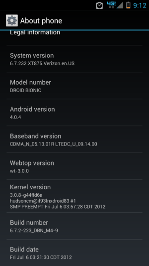

I have tried my best to search the forums for this so if I missed it being mentioned somewhere I do apologize. I'm trying to be extra careful because the only reason I even have a Bionic is because my friend gave me her used one after my Rezound died and I don't want to lose another phone. Basically, when she had it she updated it to ICS using a leaked ota because of data connection issues. It fixed the issues, but now the phone can't be updated using the official JB OTA. My question is can the ota be flashed somehow. I don't need the phone to be rooted (my Rezound was so if I absolutely have to I can do it), I would prefer just to be on stock 4.1.2. I'm including a screen shot so everyone can see what version I am running. I've only had the phone a day so I appreciate the info. I'm not a developer, but I can certainly flash ROM's no problem.

HoB - House of Bionic will definitely be your friend for this. I think you will have to first get to the ICS OTA (246 I think) then you can apply the JB OTA update.
Just use house of bionic to flash the 98.72.22 jelly bean fxz. 20 minutes of flashing and whamola your on jb

Yes. I just said the same thing on your xda thread. HoB fxz keep data option with the jb fxz will do what you want but make sure to take the time to read, read again, then do. It's very easy for those that follow the instructions.

You won't brick it. But I get annoyed when people jump into the House of Bionic without reading first and then ask stupid questions that have already been answered in the material I put together. It's really not difficult. You basically install the latest moto drivers, the HoB install, the HoB rsd install, create a 98.72.22_FXZ directory in the HoB directory, drop the 98.72.22 FXZ zip file into the new directory, connect the phone to USB (NOT a usb 3 port), load up the HoB, and FOLLOW DIRECTIONS. That's pretty much all there is to it. I made it as simple as I possibly could.
