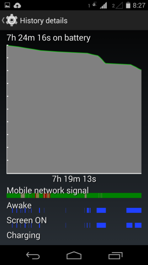

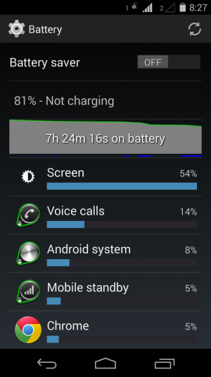

Hi all !
This is my first post after a really long gap on this forum, and I am writing because the battery consumption of my brand new Moto G is getting out of hand.
It's not even been a week since I got it (shipped with KK 4.3). Initial impressions with the usual basic apps (flashlight, gmail and other updates, notes, an office suite etc.) were very positive. I noted with some surprise that the processor seemed to be mostly in the off state (going by the Awake bar in the battery stats). All this promised a very good battery life (I am also a light user and go easy on the internet).
WIthin a couple of days I made the update to KK 4.4.2 which went off smoothly. Before making the update I had taken the precaution of performing a factory reset using the menu option. All apps were reinstalled and everything was running as smoothly as before. I then used migrate to transfer sms, phonebook, and pictures from my old samsung phone.
However, the upgrade seems to have messed up the processor and battery relationship. As you can see from the screenshots here the screen is consuming the maximum battery power. Note that this has come about despite the screen brightness being set at less than 20 % most of the time. I played around and tried to disable any extraneous apps to see if they were somehow leading to this problem. However, I was always seeing in the batt stats graph that the bars for the screen and the processor awake were moving together. In other words, DESPITE low screen brightness, the screen was consuming most power because it was KEEPING the PROCESSOR on ALL the time!
Eventually when this didn't work I factory reset the phone again and this time did not install any apps. However, the problem persists and I am now wondering if I need to take it in to the Motorola service centre.
I am attaching screenshots of the battery stats here taken a few minutes ago.
Other than this alarming issue the phone is working like a dream!
Over to the community!
Many thanks!
Your screen is always going to be the biggest consumer of your battery. Just looking at these stats, I wish my phone was as good as this, and I have the Moto X. Look at this a couple different ways:
1. Yes, screen has chalked up 54% of the use...but that is 54% of the 19% USED. So really about 10% of the battery drain is due to the screen.
2. You have used 19% and have 7 hours on the battery. Theoretically with this information, you can get about 32 hours on a single charge. This is more than outstanding.
You said it hasn't even been a week, and you have this good of a battery. The battery is barely broken in, so you are most likely going to see even better performance out of it.

Looks normal to me. Do you have something to compare it to? Which phone are you coming from?
Usually, when your screen is on it is because you are interacting with your phone. I would expect your processor to be "awake" when your screen is on. If your phone is awake the entire time that the screen is off, then you have a problem.
I'm getting 5.5 to 6 hours of screen on time with my Moto G. My N4 would struggle to get to 4.5 hours of screen time on a single charge.

Like I said the immediate comparison is with the same phone before I made the upgrade to KK ! While it was running on 4.3 I had been surprised to see that the processors were almost never awake even when the screen would be on for extended periods. In that case I used to get really thin bars in the "awake" section even as I would see long elongated bars right underneath in the "Screen ON" section.
I think my primary concern is that this seems to be happening because of some changes to the Android OS (I am not running any apps at the moment and the battery/processor relationship remains the same with screen on making the processor work constantly). If that is the case is it okay or not given the rule of thumb that says that the more the processor keeps working the more the battery consumption.

It's normal! If the screen is on the phone is awake - at very least one processor is chugging along at lowest clock waiting for a touch and updating the status bar icons etc.
IMHO Moto G's original JB4.3 battery reporting screen was bugged for failing to correctly report phone awake with screen on.

As others have replied, this is normal behavior. My graph is almost identical.
Posted via Android Central App on my Moto X
This reminds me of something: I know a lot of people (like, say, me) have been shocked when switching from something like an HTC phone to a phone with stock Android because their cell signal dropped from a constant 4 bars to just 2. Then you start to consider "what if the HTC signal meter was never accurate in the first place?", and it all begins to make a bit more sense (Oh, God... sorry, no pun intended). Over time you start to trust your own experience about what's working and what's not!

Can anyone explain what the graph means please and what the little blue lines beside 'Awake- Screen On and Charging' mean?
Thanks
Thanks
It's a color bar graph to indicate when the device is awake (say checking in on Google for random reason), Screen on is when you have the screen lit up, and charging is when the phone is getting a charge either by AC, DC, or via USB.
