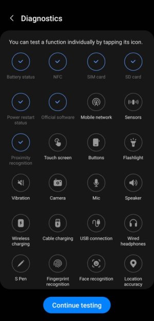

If your on andriod 12 yet go to device care and under diagnostic test battery , if not then Samsung members app under diagnostic.
Try charging the battery to 100 then turn off for 24hrs and when open what percentage its on ? Should be 100 or very close with no load can see if battery can hold a charge .Screenshot_20220119-214206_Samsung%20Members.jpg
Try charging the battery to 100 then turn off for 24hrs and when open what percentage its on ? Should be 100 or very close with no load can see if battery can hold a charge .View attachment 340643

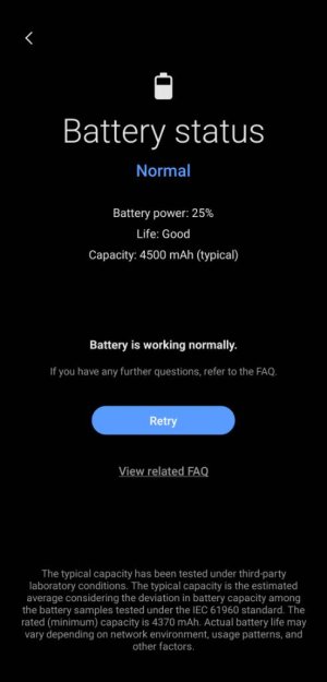

Does that run a battery health test?
Looks like it's similar info -- it just tells you in plain English what the battery health is, and if the battery is deteriorating, then presumably the capacity that's shown will be significantly lower than what it's supposed to be.
Yeah , I kinda like built in diagnostic over another 3rd party but that just me .
