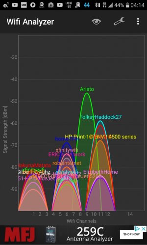

If you have that many WiFi signals in your area, I would recommend doing a site survey. I have never had a problem with my V20, but I do use a program called "Wifi Analyzer", there are a few apps with that name, the one I use is made by "farproc", but I'm sure other apps do the same thing.
(Reference to attached pic)
Once you have the app installed and open, if it doesn't default there, click the EYEBALL looking icon near top of app and select channel graph. This will show you all the WiFi signals near you, their signal strength and the channel they are using.
The number directly under the peak of the arch is the channel number a signal is using. In my area, it seems most AP's are on ch. 1, ch. 6 or ch. 11. My AP is named Aristo (yeah like the cheap LG phone), you can see it is on ch. 9. Basically pick a channel with the least activity or overlap, and manually configure your AP to use that channel. I'm using 2.4GHz since I still have some older devices that don't have 5GHz. The app will do either. If using 5GHz, click the light grey area under the word Wifi to switch.
This may or may not fix your problem, but it never hurts to have your AP on the least congested channel in your area.
