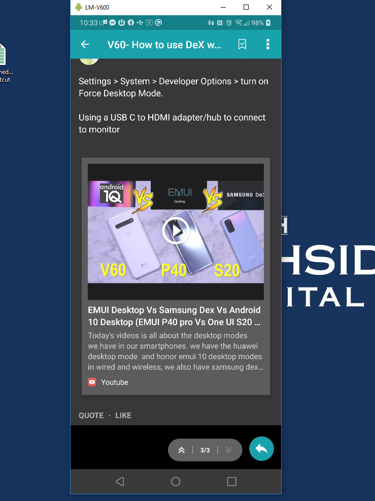

Check out scrcpy. I have been using it for a year ever since Visor stopped working after an android update on my V30.
https://github.com/Genymobile/scrcpy
Works like a charm on my work PC so I can be at my desk and not actually have my phone in my hands.
