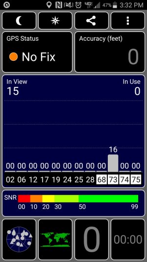

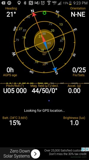

Here are screenshots from the two apps. I'm starting to think it is a hardware problem. In the second app, it just says "Looking for GPS location" and never loads.
