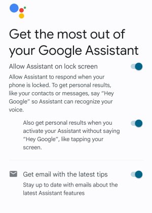

Also, I thought I had found the missing link with this setting shown on the attached photo... But it did not make a difference.

Well, I think that did it. I cleared cache, and cleared data... And force stopped Google after deleting all of my contacts.
I then resynced my Outlook contacts to my phone, and all 600 contacts came over immediately.
It populated my text message history with the proper name for each conversation, and now my voice assistant will dial any name from my contact list.
One hiccup still remains, if I switch what is apparently my default Google account to a different Google account, it will not dial my contacts by name... Again, even though they are not Google contacts...rather, again, they are my outlook contacts synced to the phone.

That's exactly what I was thinking (and why in previous posts I asked if Assistant was pointing in the right Google account). Unless you use your default account, it will not be able to access personal results from the phone. Glad you got it sorted out though!
