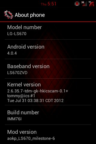

We ARE voulnerable... i used dylan reeves test and it sent me to my dialer with a code for my meid(his test displays that)
Tested on Cold as Ice a17
Did it actually pull your meid? or just display a dialer code that didnt do anything? I no longer have a Optimus S to test this on, so I am curious.
Optimus v running Gingerdx rom is vulnerable. It actually pulls the entire meid. Scary

Whole MEID is shown

This does NOT mean the Optimus S is vulnerable. It simply means there is a dialer code the brings up the MEID.

*#06# in the dialer shows the meid on the optimus s.
*2767*3855# is the code that is supposed to factory reset the phone, I typed this into the dialer of my optimus s and nothing happened, so presumably the optimus s phones are not vulnerable, at least to this code. If there is no code that you can type in to reset the phone then they are not vulnerable at all.
