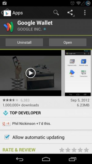

Just renamed the build prop like you mentioned here, rebooted and it instantly upgraded! Nice find and THANK YOU.

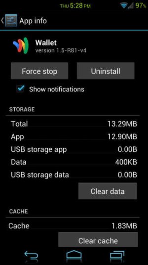

New update to wallet. This trick still works.
This isn't working fo rme. It will allow me to find and install it form the market, but it still gives me the message saying it isn't yet available for my device... :/
EDT: scratch that.. it worked after clearing data on Wallet...which is odd being I didn't have it installed before (just flashed a stock factory JB image)
