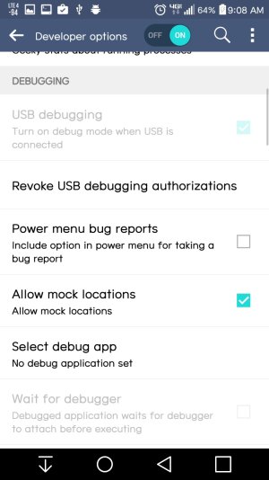

I have the Verizon G4 and was able to get wake lock detector to work without root. Adb is required. I installed the drivers that were available when first plugging in the phone. Then enabled developer options and usb debugging and mock connections. Other than that you can follow the instructions linked to in the wake lock detector app page.

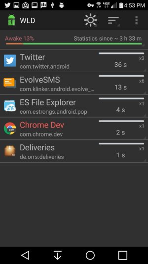

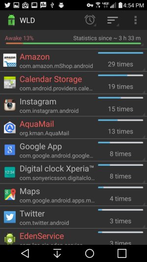

Well, I was finally able to get this to work for me!
I had run the app on my recently rooted LG G Pad 8.3. Nothing was awful but my local news app. It had more than 800 wakeup triggers while the next highest app (my e-mail app I think) had 100. I uninstalled the news app from the tablet and the G4 (figuring it was probably not just misbehaving on the tablet).

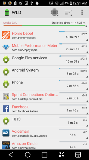

Now, with the Detector stats available on the G4, I don't see anything that jumps out to me as alarming...but I am admittedly a novice with this particular thing. Anyone see any causes for concern (note in the last screenshot that I don't think I've actively used the Amazon app at all today...)?
Thanks.

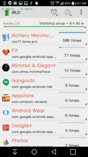

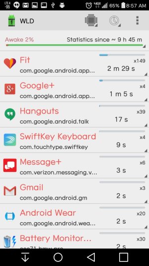

this is what I had yesterday. Now that I have using it figured out. I didn't realize there were settings in the apps I needed to change. Advanced mode was not checked and statistics since unplugged was checked and so it only showed user installed apps and only since I plugged it into the PC to run the commands. At least that is what I think was happening because there would only be 3 or 4 things in each list with almost no stats at all. This screenshot is with Advanced mode checked and statistics since unplugged not checked. Please let me know if I am mistaken on the settings. As I need to only know stats from the day. I charge to full over night, reboot it when I wake up, then unplugged it from the charger and go about my day. At the end of the day I assess the situation to figure out what is wasting my battery. So far I am very frustrated. Because if I configured WLD correctly I got my work cut out for me on figuring out the causes as you can see by the screenshot. Things aren't adding up to me when I look at all the other tools at my disposal and this. Home depot went rogue I think same with mobile performance meter. I have to look at today's data to compare to the rest of the data I've been collecting for about a week now.

Some apps will automatically start at startup even if you don't open the app. The amazon app is one of them. I believe it does this so that it can notify you of shipped or delivered items, wait list and things like that.
Well wld is a troubleshooting tool. It isn't going to tell you exactly what is wrong. And sometimes the problem isn't exactly the the app that shows as the highest usage. For example, an app can misbehave and ask for location a lot from Google play services . This can cause Google play services to show high usage.
Yep that is where I'm at now. I have removed the home depot at and mobile performance meter. MPM wasn't as draining as home depot was for misbehaving. I gained 4 hours extra hours of idle moving me from 12 hours on a full charge to 16 hours on a full charge. This is my first day with MPM uninstalled but I'm not quite to the data collecting point for today. So I can't confirm any gain from it's removal. I still have stuff to identify that are keeping my G4 awake. I've gone from 50% deep sleep to 65% deep sleep. I still have 3 hours of wake time unaccounted for.
