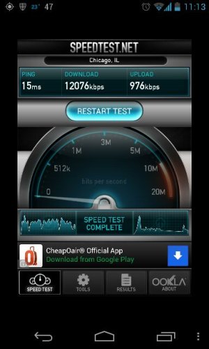

Here is what I get on my cable internet with 2 bars.
I'm not sure what type of connection you have but that is not the worst I have seen. I have a very fast 100mb connection and I am getting 34203kbps DL and 5410kbps UL. So unless you are paying over $100/ mo. for your internet I would say that is normal. If on the other hand you are accessing the internet and it is super slow them you may have an issue. I find that downloading a large app is a good test. Try that and see how fast it finishes the job.
