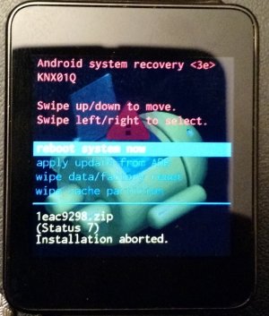

Twice now, I gotten a system update for the watch and both times it has failed. It reboots the recovery screen.
I not sure if this the new wear 5 update or something else. This last time I had it do a factory reset in hopes of fixing the problem.
Anyway one else having this problem?
The watch version is 4.4W.2 and says it update date. The wear app is version 1.0.5.1530507 running on a Moto G GPE 5.0.1 assuming any of that info helps.:p

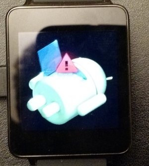

Just got another attempt at the update. Failed.
sorry for the poor quality on the first one, if I touch or move the watch, it moves on to the second the recovery screen.
