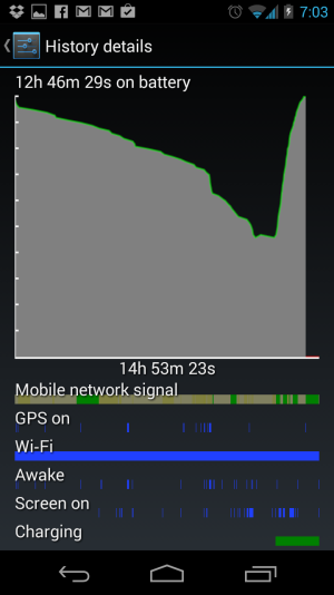

I have had a similar issue lately. I always put my phone on the charger overnight. Here lately, I'll find it the next morning saying the battery level is 0%, but it knows it is on the charger and says it is charging. As soon as I disconnect from the charger, the phone shuts done saying it is out of battery juice. When I turn the phone back on, it shows a full charge. A simple restart fixes it every time, even when it is still on the charger.
