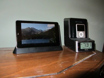

When I first started seeing the Nexus 7 dock on the Internet last August, I thought it was kind of a waste. Then once android 4.2 came out with the dream feature, I started to come around. I don't use a case much, and I decided it would be good to have a place for my tablet to live.
So here it is :
I have the display set for dream mode when docked. Under dream mode, I chose pictures. This took me to a screen that allowed me to select from a number of gallery folders. Basically, when I drop the Nexus 7 into the dock, it turns into a digital picture frame.

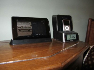

As you can see from the photo, I have it next to an iHome iPod playing alarm clock. One of the things I wanted to do is to be able to play Pandora and other sound apps over the better speakers on the alarm clock. Here it is with Google Music:
I especially like not having to plug it in to charge it. I hope that's saves a lot of wear and tear on the USB port.

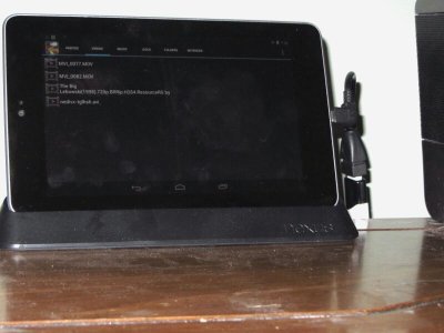

I know some people have been asking if OTG works while the Nexus 7 is docked. The answer is yes. Here it is with a flash drive plugged in and Nexus Media Importer running.
It was touch and go at first. I plugged the OTG cable into the tablet while it was docked and awake. It crashed while trying to open NMI. I tried it a second time, except this time I opened NMI before putting the Nexus 7 in the dock. It asked me if I wanted to use the dock to play media files. After I said OK, NMI opened successfully. It now opens automatically when docked and I plug in the OTG cable. Here is a movie streaming from a flash drive:

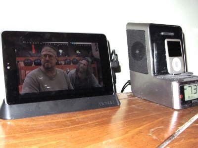

Ahem...
Here is a photo of a movie streaming from a flash drive to the tablet using an OTG cable:
