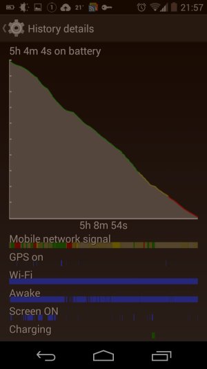

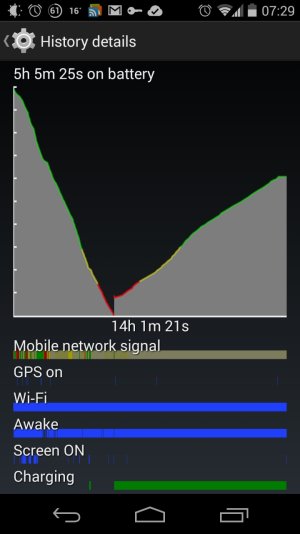

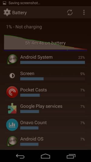

I'm getting pretty tired of this device. I really want to like it but recently, for no apparrent reason my Nexus runs very warm and the battery drops very rapidly and charges very slowly. I left it plugged into the wall charger for 6-7 hours and by morning it was only 49% charged. A few hours later when I was out, the battery was dead and the phone was hot.
What can I do, it's driving me nuts? Here are some screenshots:
I don't root my phone and I have the latest 4.4.4 update.
Looking at this, something is keeping your phone awake almost the entire time. You can try to install GSAM battery monitor that may help determine what is causing that wakelock. https://forums.androidcentral.com/e...ails?id=com.gsamlabs.bbm&hl=en&token=vNE59Pz8
Also, have you rebooted your phone recently? If not, you should try that first.
One last thing - It looks like you are in an area with bad mobile signal - that may be adding to the battery loss as well.

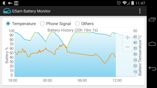

I've put back most of my Apps (just the ones I use regularly) and had a look at GSAM Battery Monitor and it looks fine now:
If I need any more apps, I will add them slowly one by one and monitor. Thanks for the help!
