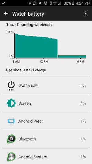

Have had no issues with getting a full day (8am to 10pm) with about 30% left at the end of the night. I went to look at my watch today and it was off. I put it on the cradle and it was completely dead.
Here's the battery graph.
How would this happen?

So it seems like having WiFi on and using watchmaker premium as the face destroys the battery. Just watchmaker, no WiFi is fine, just WiFi, standard face is also fine.
Have you verified that conclusion? This week I also encountered a dramatic battery drain that hasn't repeated (thank goodness). I hadn't changed settings either before during or after and yet the problem occurred once.
I agree with this observation. I get 2 full days battery life with stock AW watch faces with wifi on but only one day with a similar watch face using Watchmaker (also with wifi on). The 2 days is with ambient and tilt to wake on. With both those set on, the watch goes full brightness for 5 seconds on tilt, then ~ 5 seconds dim, then completely off (until the next tilt).
