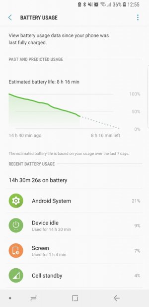

Rico H
Mar 29, 2018
5
I've done this and it hasn't helped at all. My battery life is nowhere near what anyone else is claiming

I have the same problem and i don't think the battery is "worn out". I have 2 phones (Samsung Galaxy S8) for about 6 months now (me and my wife) and after the last system update, like 1 week ago, the battery life dropped drastically, on both phones. Most of the battery is used by the android system and device idle and i have to ad that there is no new apps installed and i don't do anything different from what i use to do.
