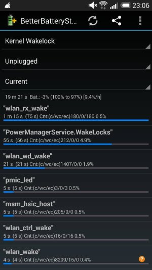

I've attached a screenshot from Better Battery Stats. What does this mean?

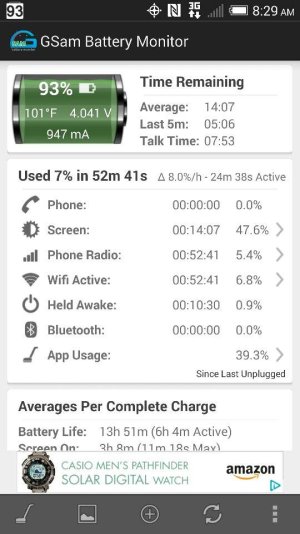

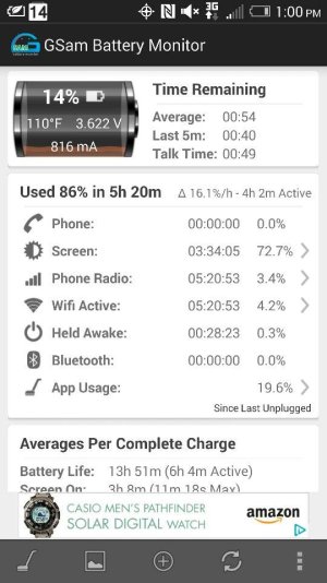

Here you go friend. Finally got some time to do this. I've thought since the update that it's my background screen.. it forces me to have news updates or ESPN updates.. whatever. Before the update I just had a plain black screen with that stuff off.. now even if I click to remove that from my main screen it doesn't go off.
Here you see I have 93% when I go into work. I didn't touch my phone for 4 1/2 hours and when I go on break at 1pm it's nearly dead. And it did die at some point during my hour break as well.
Hi in the second screen you can see that is says the your screen has been on for 3 hours and your cell radio for 5 hours ... The screen has used up 72% of your battery , I would say that this is your symptom to a problem which is , why is your screen stay on .
I suggest you check in your settings menu under screen display " Auto-off " or " sleep " setting is not set to stay on for more than a minute or two .
