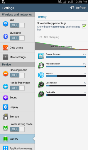

Tablet is the LTE version from T-Mobile. The tablet has lately not been holding much of a charge when the tablet is idle for almost the whole day. If left with low activity, it could last at least 5+ days on standby. Now it can't even last more than 15 hours before warning of low battery.Screenshot_2016-03-22-22-29-44.png

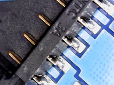

However, quick discharge is common problem of Samsung tablet due to cracked battery connector. Re solder will fix it easily
