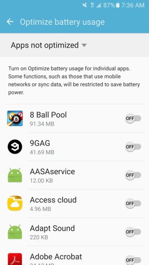

What is "Optimize battery usage"?

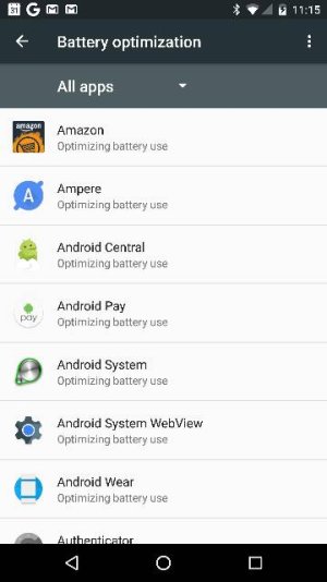

Doze, part of Marshmallow. Unless you changed those Samsung seems to have done their best to confuse things, it looks like Doze is effectively disabled by default. On my Nexus 6P all but a few are "optimized" (those switches would be in the ON position) and I'd need to act to change that. So, with all your apps not optimized, Doze will never activate.
Okay, thank you! I've been searching for Doze settings for a while without success. It's strange that they wouldn't label this option "Doze".
And btw, every app was on by default, but since I didn't know what this feature did, I disabled them all temporarily.

Based on what I've read, and having had the Note 5 on T-mobile until this morning, the battery optimization feature you're looking at is a Samsung feature. It was on the Note 5 since the day I got it. And based on the article link posted it would seem that doze is just built in and does its thing. Not something you can tweak.

This appears to be the Samsung customized version of the doze interface. Here are some caps from my 6P, I hope. Ok, 1...

I agree. We have a Samsung Galaxy View tablet with Android 5.1.1 and it has this Optimization feature too. So it is definitely not Doze which is a Android Marshmallow (6.x) feature. It's a Samsung feature.
That's not Doze. This feature came in 5.1.1 in Samsung towards end of last year.
