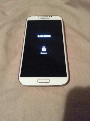

Just curious. I have a s4 with a padlock on startup screen and I didn't know if that meant i was rooted. I just bought this phone off craigslist.
What does the boot animation look like? The stock boot up is the Samsung logo and of course the branded Verizon startup. If you have a different animation. You are rooted. Also. You can check the about phone screen. It will give you other various info.
Sent from my SCH-I545 using Tapatalk 4
It starts out with a unlocked padlock then goes to the Samsung screen then the att screen.

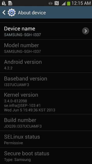

Ok. Do you know how to take a screen shot?(hold power and volume down) Go to settings... About phone. Take a screen shot there.

Hmmm. It doesn't appear the anything different is flashed. Do you have root access?

Don't know what that is. Here is the start up screen.

If it's AT&T phone, non of the s4 devices bootloaders are unlocked. It means you have rooted phone since AT&T splash screen is showing.
Go to settings -> more -> about device and check what baseband is. If its MF3 then you are stuck on root as of now and no way of putting custom ROM nor unroot.
If you have MDL or previous ones you can install custom ROM or able to unroot if you desire stock everything.
Unlocked padlock means your software has been modified (root access/ custom rom etc.) It does not mean your boooader is unlocked.
I provided this information based on your post (AT&T carrier and unlocked padlock).
But keep in mind if you do have MF3 baseband, DO NOT try to do anything at this point or you will brick your phone.
Developers are working hard on unlocking AT&T device's bootloader or safestrap to install custom ROM leaving stock ROM untouched.
It says mf3. So I cant just have stock?
