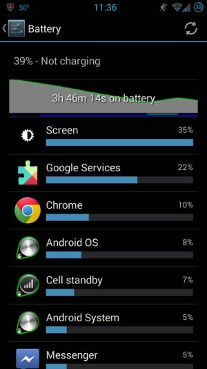

So I just bought a new stock battery for my galaxy s3 i535 because the battery life I was getting was just ridiculously bad, and since I've gotten the new one in there I have not seen an increase in battery life at all. So it has got to be something running in my phone that is the culprit. Any help would be appreciated.

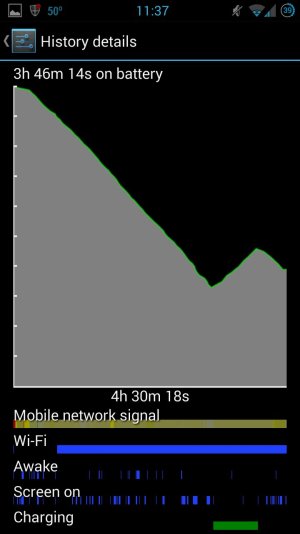

Have you tried setting your phone to Airplane mode for a while and see if the decrease in battery is still there? From what I see, your mobile signal is dreadful, and this might become the biggest drain.
^ What he said.

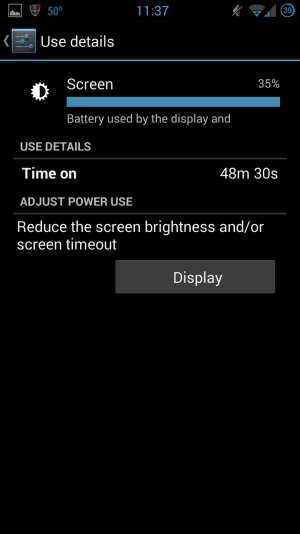

Your Awake vs. Screen on looks normal; Google Services looks rather high, but with so little screen on time it's hard to say.
And it looks like Juice Defender has turned mobile data off since you have a (rather weak) Wi-Fi connection.
But your cellular signal sucks, and that could easily kill your battery in no time. Do you work in a building where this is a widespread problem, or just live in an area with poor coverage?

Embarrassingly, I can't tell if that Mobile Signal reading is bad, since I'm a little color blind. But I can usually see red, and I don't see it on that bar--why does it seem bad?
It's unfortunate that they don't have a legend to explain the various colors for the Mobile network signal, but there's a little bit of red near the beginning, and then mostly this dingy yellow. On top of that, all the screenshots show only 2 bars of cellular signal (in fact, after further review, the 3rd screenshot shows no bars).
Have you moved recently, or changed workplaces (or wherever you spend much of your time)?
Edit: for comparison purposes here's what a good signal looks like.
(Note the dark green color.)
Sent from my rooted, debloated, deodexed Sinclair ZX-80 running CM 10.2 using Tapatalk 4

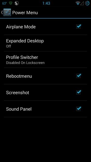

But it looks like Airplane Mode is on (at least, in one of those screenshots), which should turn off the cell radio as well as mobile data. So poor cell signal should not be impacting battery use as long as Airplane Mode is on. Did you have Airplane Mode on during a large proportion of the time that the battery was draining quickly?
O put it into airplane mode... Sorry didn't re read above post till now. Thanks for help guys I'll let you know how it goes
