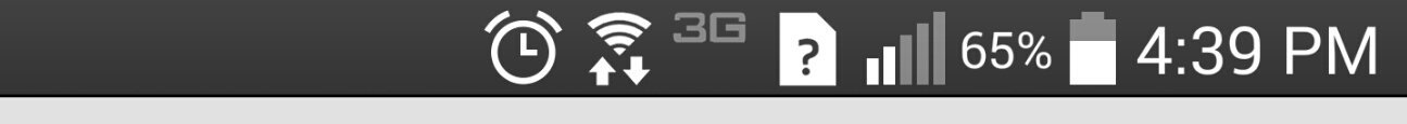

What's this question mark SIM?
bobrush00
Aug 7, 2014
2
I'm with Verizon, calls and messages and everything works just fine. It'll go away when phone it's reset but keeps popping back up randomly.
Sent from my VS985 4G using AC Forums mobile app
That looks like an issue with the SD Card. Power off the phone, remove the card & run a scandisk on it. If that goes ok, reinsert the card (make sure it's seated in the slot properly). If you still see the icon, try a different SD Card.
I just got this icon showing up in my status bar today. In the middle of the day. I haven't touched my SD card, physically, since I got my phone. But have been using files on it almost daily.
Going to try and re-seat it. Hoping I don't have to format it now.
Edit: That did the trick! Re-seat. Strange, considering that access to it still worked. Still don't understand what that icon means. Is it a warning?
It's happening to me right now but in my case, I have an AT&T SIM in a Verizon LG G3. Phone is unlocked and rooted.
I had the same question, and my device doesn't have an SD card. I use Verizon. Any other ideas? Thanks.
