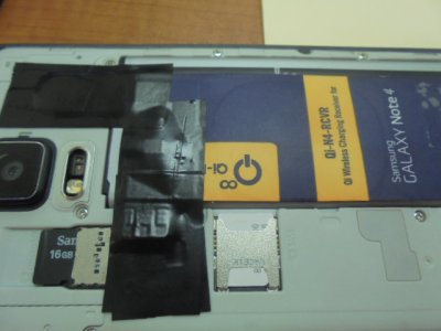

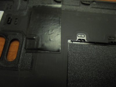

UPDATE....After some modifications working like a charm. Had to use a small amount of electrical tape to secure the contacts onto under the rear cover. Also put a small piece of tape on the inside of the rear cover to press on the contact. Success!DSC06253.JPGDSC06254.JPG
Say, can you post a shot of the back cover on the phone? Just curious to know if any "bump" whatsoever?
