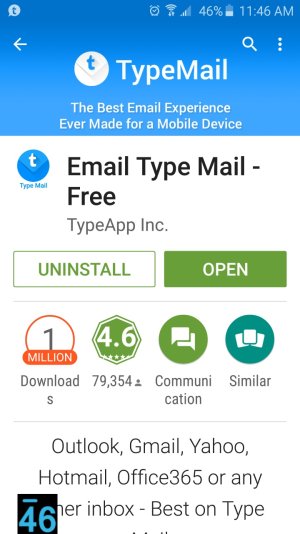

Try out Type, you can add all your emails accounts. uploadfromtaptalk1434420615185.jpg
