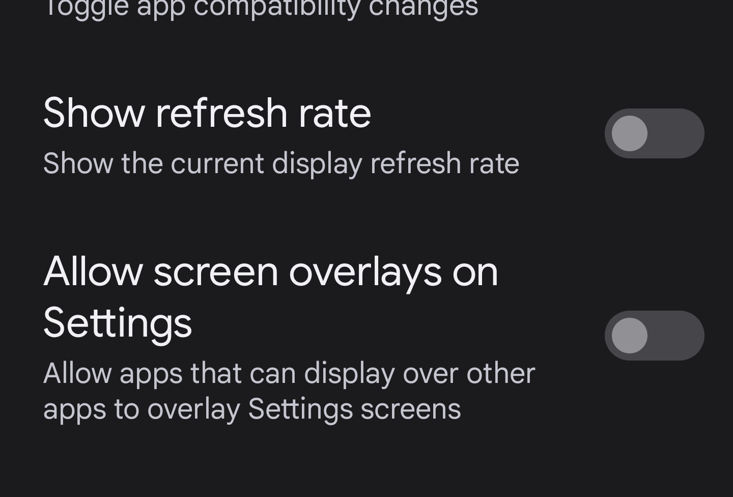

Check "Developer Options" in Settings ->System->Developer Options and see if "Allow Screen Overlays.." is turned on. See attachment. If it is then turn it off and go back into the app permissions that you've tried before. Hopefully that will work.

I did try Smokeaire01's suggestion, and I was able to access the Developer Options menu, but my menu options don't seem to include "Allow screen overlays on Settings" anywhere, or even "Show refresh rate." I suspect that my model of phone may simply not have those options, or that I may be doing something wrong. I am still very thankful for the suggestion, though.
