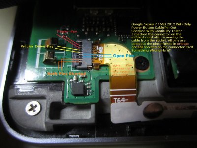

I have a Google Nexus 7 2012 16GB WiFi Only tablet (Lollipop 5.0 OTA updated in November 2014) which started behaving strangely all of a sudden. On pressing the power key the display comes up and goes blank again. I switched off the device by holding the power button (long enough to switch off the device) and when I switched on ... the Google Logo comes up ... then after 3 seconds the tablet restarts again into an infinite loop. I finally had to remove the battery to switch off the device.
I bought this device in US (sometime in October 2012) so I am out of warranty. The Google/ASUS Service here in India is not that encouraging for me to carry an out of warranty item for repair. I am aware of the risks involved in flashing device software and it would be the last option (I can’t afford ASUS/Google Service pricing model which seems very expensive).
So suspecting the power button cable … I checked both the cable as well as the connector on the motherboard and I have pasted the image here along with my findings with the continuity tester.
Can someone tell me if the button power socket and button cable is OK or NOT.
