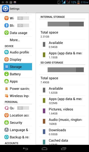

So I am using a tablet that runs on android 4.2.2 jelly bean and yesterday my youtube app got deleted on its own. I've been trying to download it from Play Store but whenever the download finishes and installation starts, they show up "insufficient storage" although I have plenty of storage. I installed other apps and all of them were successfully installed but youtube. I even tried downloading latest version of youtube apk but when I click on it, it shows "problem parsing the package" and older versions won't install either. I'd be grateful if you could help me out

Welcome to Android Central! Which tablet? Is it a direct-from-China device that isn't certified for Google Play? YouTube is preinstalled on virtually all devices these days, which means you can't uninstall it. You already looked in your App Drawer for it?

I am using Qtab Q400. It is our country's own device and I really don't know if it's certified from Google or not. Yes it was a bloat ware and I couldn't uninstall it but it got uninstalled itself. I have looked everywhere for it but its not anywhere.

If the device didn't come with the Play Store, then it's not Google Play certified. Did you have to manually install the Play Store app?
Try going to Settings>Apps, tap Menu>System, and see if YouTube is listed as Disabled.

Go to Settings>Apps and see if there is a separate category for Disabled apps.
Also, see what happens if you boot into Safe Mode. On most Android devices, while powered on, press and hold Power until the Power Off menu appears. Press and hold the Power Off selection until the Safe Mode prompt appears. Tap OK.

Wiping the cache will not affect your personal data. Just make sure you don't select Wipe Data instead (unless you're ready to try a factory reset).
