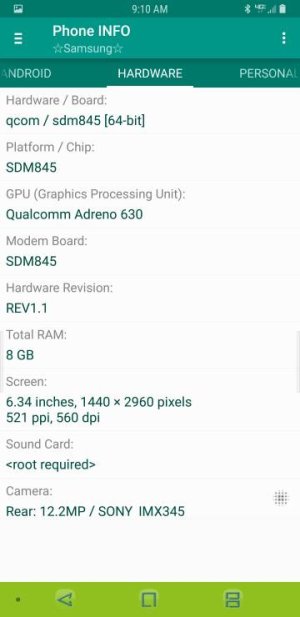

Another possibility is a counterfeit phone. Use an app like CPU-Z and to find out which CPU is in the phone. It should be from Qualcomm or Samsung (depending on the variant). If it says Mediatek or something else, then it's a fake/knockoff.

Samsung Info is another good app, that is free, to verify what your phone is made of.
