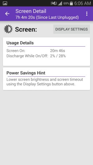

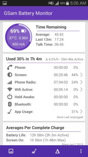

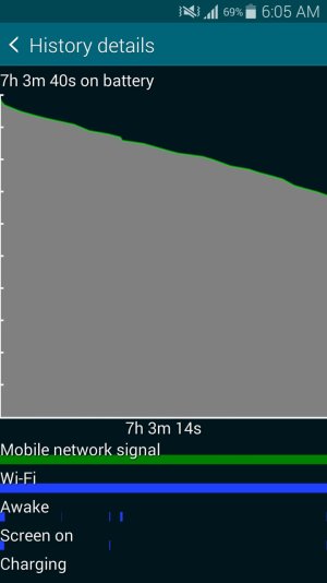

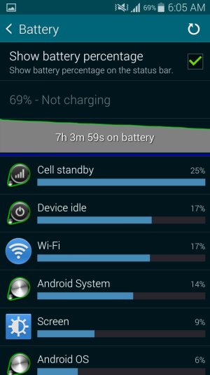

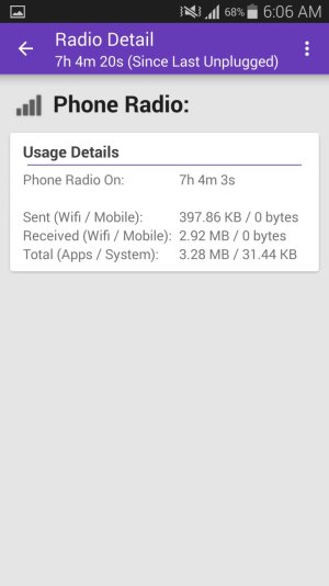

It shows that Phone radio and network are draining my batter (as shown in attached images) Also how can screen brightness drain battery when kept idle screen locked mode overnight? (as shown in attached images) Please Help. I have attached screenshots when I found 69% battery remaining in the morning (kept at 100% at night)

Could you post a screen shot of the battery usage screen? It's likely a wake-lock occurred and prevented the device from entering a deep sleep. If this is the case, it's likely an app or service you have installed on the device causing the problem.
Post a screen shot and we'll to pinpoint the problem further.
Re: 30-40% battery drain at night
Agreed. Charge up to 100%, then let it drain to 20-30% with normal usage, without charging in between. Then show us:
1. The main Settings>Battery screen.
2. The fullscreen battery graph screen (which shows Awake time and Cell Signal Strength).

Hi, I am attaching the screenshots for reference:
Screen usage in idle mode and phone radio in idle mode are my biggest concern.
