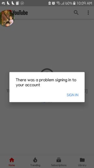

Somehow unable to update YT
This is in response to a message from an old post of mine. Surprisingly, the cache wipe worked, but before I did that, my dad came to check on my phone. He said I should do a factory reset and forget about all my data (which I didn't) he then somehow deleted Youtube and the built-in updates. Right after he said he couldn't do anything, he left. Then, I managed to get my phone to power off to perform the cache wipe. I remembered he deleted YT so I tried to reinstall the updates but errors were saying there was another app blocking access to Google Play. Which I didn't know. The model is SM-G600S. Any thoughts on this?
