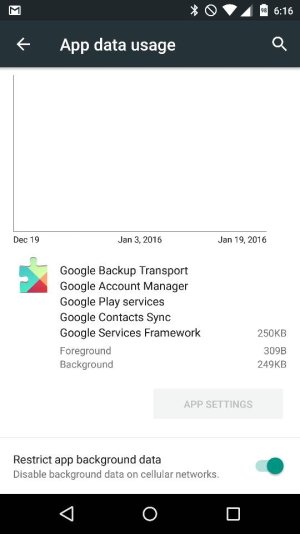

If you restrict background data on Google Services in the data screen, this issue goes away.
However, a new issue seems to crop up. Android OS will now use more power due to "mobile radio active" instead. It uses more than it would normally, but I have found its still less than what Google Services would have used before.

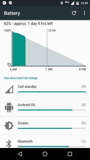

Yeah it's a real problem in Lollipop. I can tell you it is fixed in the Marshmallow update. My battery is lasting beautifully on MM now.
This is off charge at 5:30 Am and its now 12:30pm. So that's pretty decent in my books, and I have had music streaming over Bluetooth since about 8am. Screen on 45 mins.
