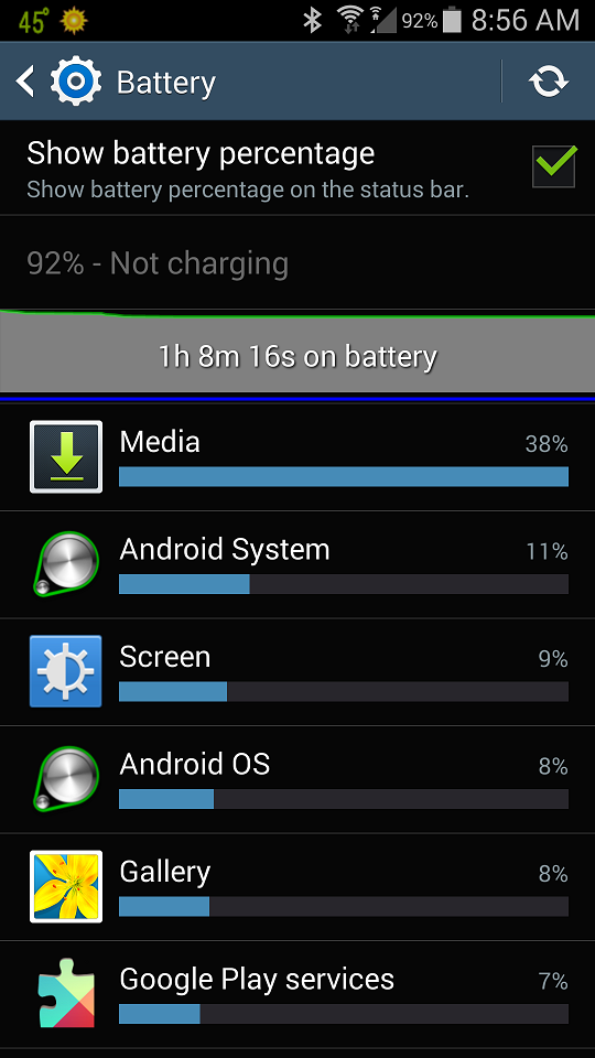

I have a Verizon Galaxy Note 3, stock ROM, non-rooted. Very pleased with it overall. The KitKat update seemed to somewhat diminish battery life, but it remained acceptable.
In analyzing this further, it seems that "Media" consistently consumes a lot of the battery power, for reasons unclear to me. I just updated to 4.4.4, hoping that this would change, but after a short period of time, it's back up there, as the following screen capture shows:
According to the Phone's description, this includes:
Download manager
Media Storage
Downloads
I do have a 64gb MicroSD Card, Sandisk, which has never given me any problems. It is about half-full - mostly photos (copies of DSLR images from my Desktop), and several movies.
But why is "Media" using so many CPU cycles? And more importantly, how can I stop this? I would guess my battery life would be significantly improved if I could prevent "Media" from consuming so many CPU cycles.
It has been this way for months, and the screen capture above is quite typical for my phone.
Any insight appreciated.
That's definately NOT normal. Typically most users will see screen as #1, and Android System as #2.
I haven't done much research on it, but from what I understand Samsung's media scanner will periodically scan your device to make sure it's media catalogue is up-to-date. The problem is when it encounters a file that is exceptionally large or it has issues with (for whatever reason). Then it will just get "stuck" at that one file, and unable to process any further, but sitting there and continually trying to process the file it got stuck at. It appears this is what's happening to you (as a rough educated guess).
If you have another microSD card, copy the files over to the other one and see if things improve. If not, plug the card into your computer and copy all the files there temporarily. (Double and triple check that everything copied over correctly before continuing). Then pop the card back into the phone and format it - which will wipe the whole works and you can start fresh. Copy all your files back to the SD card and see if things improve.
And as an aside, Samsung seems to have issues with SD cards over the long term. Some brands seem to be more reliable then others (you'd have to research which ones) but it seems that almost all brands have experienced "Sudden Card Death" where the microSD card suddenly becomes corrupt and recovering the files from it may or may not be possible (even from a PC). Hopefully this will help you somewhat.

Well, Media was back up there within an hour or two...:-[
Next step I've taken is to boot into Recovery mode, where I wiped the Cache Partition. Recharged the phone to 100% to reset the battery stats, and will see if this does anything.

Thanks for the suggestion. In the few hours since wiping the Cache Partition, Media is back up there, as #1, so clearly I haven't gotten to the bottom of this yet.

I'm still wondering if perhaps you have a file on there somewhere that the media scanner just can't process. I'm starting to think that's where the problem itself is.
Interesting thought. You mean like, perhaps, a particular file extension? When certain files are copied over the Android OS does give a warning of sorts, that it isn't capable of playing them (like a .wav file, for example), indicating that the file can be stored, but not played. In this case, there are 3rd party apps that can play/open this type of file, even if they're not handled natively.
Or do you mean a corrupted file? If so, wouldn't this have been eliminated by the format and re-copy process? Or if not, how would I identify the corrupted file?
Just restarted the phone; after 6 minutes, Media is still on top. Not a lot of time, but worrisome....
Great minds think alike!! I was reviewing that page a couple of hours ago, and am working through some of the steps.
Reformatting out of the phone, in the phone, transferring files in directly on the Desktop, transferring files in via USB directly to the phone - none of these seem to make any difference at all.
I had previously tried deleting cache/data for Media Storage several days ago - didn't fix the problem.
I'm thinking that you're correct that there are certain files that are creating problems. Some threads I found indicated that .mp4 files were creating problems for them. I had a dozen or more movies on my card: both .mp4 and .avi. I went ahead and deleted all of the movies, and will monitor. I re-deleted the Media Storage cache/data, to let it rescan the MicroSD card, to 'reset' the process.
As expected, Media was pretty active initially, as it had to rescan everything, but seems to have quieted down to a significant degree. Media is no longer #1 on the list, having dropped down to #2. I'm hoping that the movies were causing the problem, but we'll see.
I also have a moderate amount of music on the card, which I'd hate to delete. But I also have quite a number of photos - copies of DSLR shots over the last 14 years or so, so it's probably several thousand jpegs, organized by year and month. It's very neat to be able to see any of those photos whenever I want, so I would really hate to have to delete those.
Will update when I have more info. I appreciate your working along with me on this!
