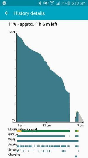

I'm having the same issue with my Note 4. Seems to happen randomly when i use the camera. Worst one was at 65% but generally happens around 30%.
Re: Battery Life Dies when at 30% and sometimes 50%
Same. Mine just died at 32%. Seems to be worse since recalibrating. It used to die around 12%.
