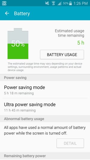

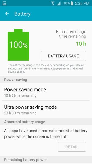

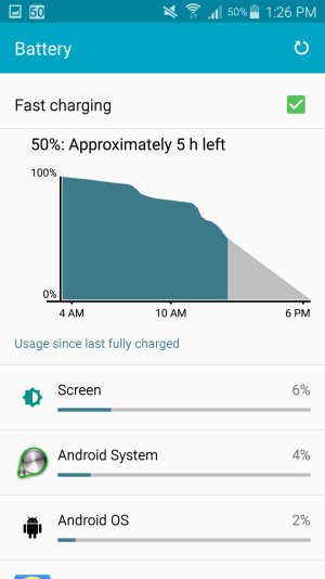

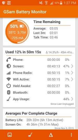

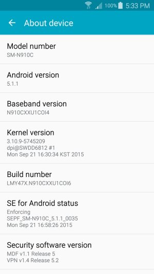

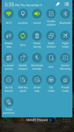

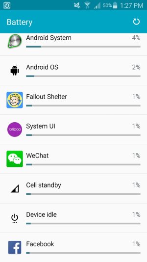

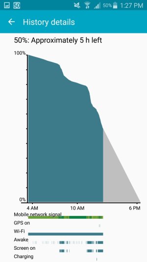

Hi! I have a Galaxy Note 4 that was heating up so I brought it to the Samsung service center and they said that the hardware is ok and they just updated it to 5.1.1. My warranty ended 3 days ago after I got my phone back and now the battery drain is just too much. The last 2 nights I would leave my wifi and sync on and I will get 15% to 20% battery drain unlike before it was around 2% to 5%. I did a partition cache wipe earlier and charged my phone. So far I got 3 screenshots to show. I hope you guys can tell me what is going on. Thanks!

I already did 4 factory reset and I just find it strange that after getting my phone from the samsung service center this problem shows up. Last night I turned off my wifi and sync and still lost 10% battery. I should just bring it back to them. Can anybody share their note 4 battery screenshot? Thanks!

The OP's Screenshots reflect the worst time remaining that i have ever seen on AC. 5 hrs at 100% estimated! And yet at 50% it is still 5hrs estimated. There is something drastically amiss here.
