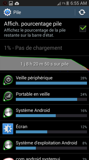

What do your battery usage stats indicate after such a discharge?
If Android OS or similar is high on the list, try using the Wakelock Detector app.
On the top this is always System android and IU syst.

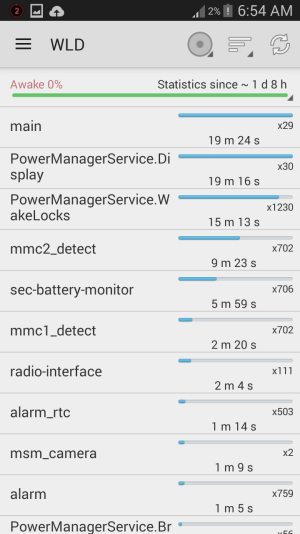

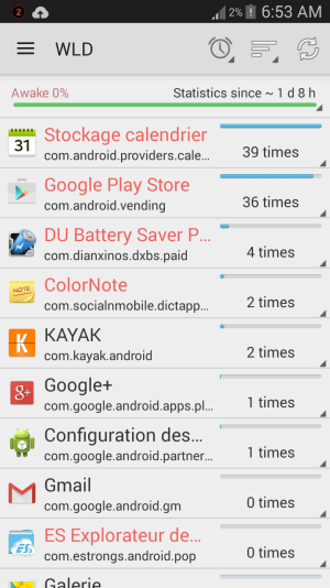

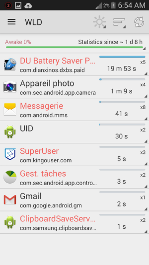

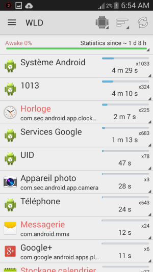

Hi,
Sorry for the delay but did have difficulty to make wakelock work on the 4.4 version of android and did have to wait for the bug to happen.
Here are the result:
I am not sure about what could drain the battery. Do you have idea?
