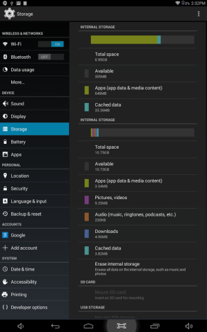

Okay, I really need help, I can't figure this out.
I have an off-brand Nuvision TM1088 tablet. It has 16 GB of storage claimed.
When I go to storage I see 2 "Internal Storage"s. The first is a measily 1GB and that apparently is where the tablet wants to save all of my apps and everything other than my media. The 2nd seems to be the meat of the machine being about 11 GB (10.75). What the heck... I have a Nexus 7 and when I go to storage there is a Single beautiful 14 GB partition, and that is it.
So my question, can I merge these 2 storages? Or can I at least make the larger of the 2 what my device defaults too? The problem I am running into is even after a clean Factory reset once all the Google Programs take up their share of the 1 GB I am left with about 200-400 MB of space for apps, so after just putting a handful of apps on the machine I get the error from the Play Store telling me I have no more storage available so I cannot download any more apps even though I have 10+ GB free on my other "Internal Storage" which the tablet won't use.

Picture showing 2 "Internal Storage"s. You can see the main one is only 1 GB and basically full with stock Google Apps.
Welcome to Android Central! It's because the tablet is partitioning its main internal storage into two partitions--a smaller one that is likely being used to install apps (and since it's pretty small, you won't be able to install many), and a larger one that acts as an "internal SD card." Unfortunately, you can't change how things are partitioned.

B. Diddy, thank you so much for the quick response. Funny I had read that guide a few times already it seems to be the Holy Grail of storage issues and I see it referenced a lot in the forums, unfortunately it does not really solve my issue as it doesn't get into the nitty gritty technical aspects of partitioning. It gives a great overview of how storage is set up, but not really how to change it.
I can't believe that my device (which is a $200 tablet sold on HSN.com with a 4 star review) only has 1 GB of storage for applications. I have to believe either I have broken something, or something broke and there is a way to fix it. I would re-flash my device back to manufacturer settings, but they don't even have the stock image anywhere accessible on the Nuvision Support Site.
Can you think of anything I can do to try to drill further into this?

What Android version is it running? The setup your device has was not too uncommon a couple of years ago. My old Razr Maxx (that was updated to Jellybean) was stuck with its Internal Storage partitioned into a 3 GB App Storage area and about 10 GB of "Internal SD" The other 3 GB was taken up by the system.
I can't really solve your issue, because it's how your system hard-wired. Sorry! I know this is too little too late, but this is one of the reasons I never recommend off-brand devices. One of the potential downsides is outdated technology.
