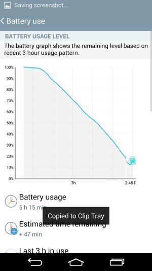

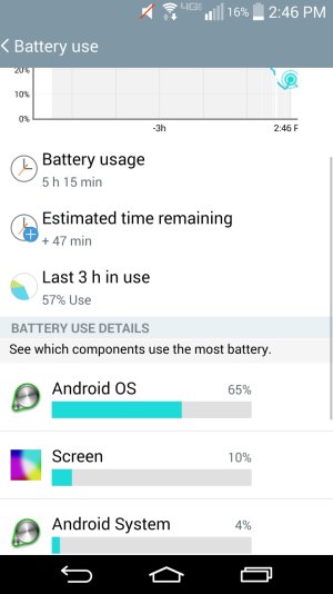

My Battery Life has gone from 15+ hours to 5 in one day
I don't even know how to explain what is happening. Nothing has changed at all on my phone! It's suddenly gone from a very healthy 15+ hour of idle/screen time every day into this 5 hour crapfest where I'm left at 3% battery by 1 PM, when it was FULLY CHARGED at 6:30 AM!
I can see here that the Android OS is taking up most of the memory, but I don't know what to do about it.

A lot of things are categorized as OS and they are running in the background.
Try freezing things you don't need and test it out.
I haven't debloated my phone since I got it replaced but I get awesome battery life even so.
If you don't reboot after a while anything you do will increase the OS and android system usage stats.
However if you manage your phone right it should stay well below 10%

Agreed with this. Charging at 40/50%? So we only use half of our battery? Seems unrealistic. Truth is, You shouldn't ever let your battery fully discharge, that could however cause problems, but not a software one. 57% usage in 3 hours is the problem.
Not sure if you are rooted or not, But if you are.. you may want to check out Wakelock Detector to see what that imposing app is.. or If you are not you may be able to get a better idea with GSAM Battery monitor, generally that app will give you a little more information.
