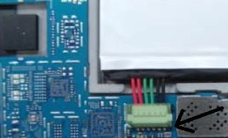

Based on your description, battery's capacity fluctuation , flickering screen, auto reboot, auto shutdown.....all symptoms of loose or cracked battery connector. Re solder the battery connector will fix the problem.
Read this threat from page 3, you will see they all have the same problem like yours, common seen in samsung tablets
http://forums.androidcentral.com/sa...te-pro-12-2-screen-flickering-problems-3.html
You can verify it by open the rear case, turn on your tablet, press directly on the battery connector when problem starts, you will see what happens.
