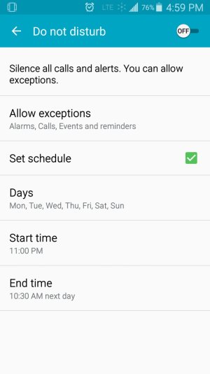

I have looked on Google repeatedly for an answer to this and have checked out several topics on this web site, none of which have helped me.
I have a Samsung Galaxy S4. When I had KitKat, I had "Do Not Disturb" mode. It worked fine.
A few weeks ago, my phone finally received the Lollipop update (specifically, 5.0.1).
"Do Not Disturb" is still there (and still titled that). I've set it up so only my favorite contacts are exceptions.
I subscribe to a Twitter account because it gives info on a game series I like, and I have it set up to send me texts immediately for the latest news. For various reasons (including Japanese time difference), this can result in 40 tweets overnight.
Twitter is NOT one of my favorite contacts (long pressing on the contact still gives me the option to add to favorites), but I'm still getting woken up by tweets from them.
I've even tried changing my settings in DND to not allow messages, and I still get text message alerts.

I actually do have "Do Not Disturb," rather than "Notifications."
I have gained a new clue, but it doesn't seem to fix the problem: In my settings, I made it so that my phone will repeat the notification sound if I don't acknowledge a text the first time. I've missed texts before without this feature, so I do need to keep it on. This is standard with my phone, not an app.
It seems to be (haven't tested it for sure, I just happened to notice recently) that while the initial alert is silenced, the little reminder notification is not. This is the one that wakes me up at night.
While previewing this message, I suddenly noticed that I do have "reminders" allowed through, but since it's linked with Events (I can turn both off, or neither), I assumed it had to do with the calendar, which I did want to keep on in case of a forgotten appointment. I'll ask my sister to send a text later tonight when she's available, and follow up on this.

I am having the same problem but unlike you I: 1. Have no exceptions set up for favorite contacts, 2. Don't have a reminder notification set up if I don't acknowledge the first one, and 3. Have only alarms allowed during DND, not events and reminders. The problem is more recent than updating to lollipop though, I think there was another update since then that did it. I also have a Samsung Galaxy Note Edge that still has the feature and it works fine on it.
Figured it out (I think): I had messages selected as "Priority" in sounds and notifications → application notifications to get them bumped to the top of the notification queue. Apparently while Samsung still calls it "do not disturb mode" it's still tied to Android's Priority mode.
