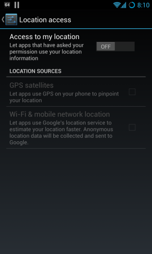

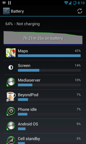

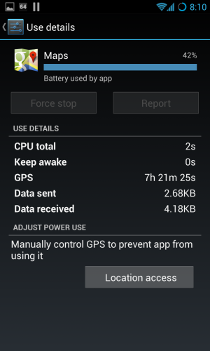

Ok, so here's some screen shots that depict kinda what's happening. I just want to figure out why and how to stop it. Of note: it has not always been this way. I've been on android for 3+ years now over a span of phones, always had maps installed and always had location access on and gps off on a daily basis. Never really encountered this kinda runaway battery usage, especially given, as you can see, all the location access is turned off.

You can try taking a look at your location settings in Maps. Mine are on, but don't seem to have the issues you're having.
Thanks, yeah, i went into the maps settings and made sure everything was unchecked. Almost the most concerning thing for me in those screen shots is that it says the GPS is on the entire time the phone was...despite the location settings saying quite the opposite.
