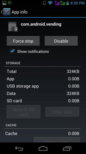

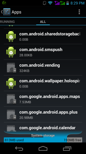

Recently i ran into a problem, i have linked all my apps including the system apps to the External partition using the link2sd app. unconsciously, i have taken the memory card and formated the whole partition. After re- inserting i found this issue and later recognised what was the cause for this.

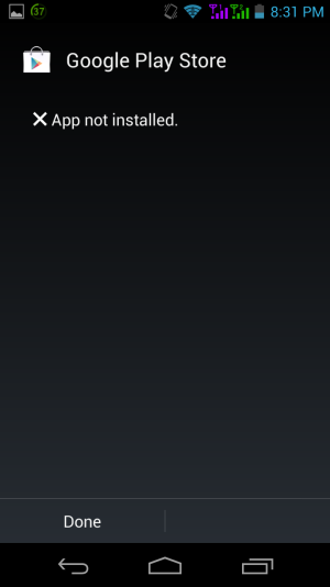

I have tried Factory and Hard Reset but it was being hung when the logo [Panasonic] has appeared. later i have tried installing the same apps which were in dead, but the result is negative.
can you please suggest a solution for this ?
