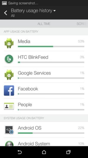

Re: why my battery life is draining so fast?
Do you have an SD card inserted? A corrupt media file can cause that.
Yes i have. I took it out but it didn't affect on battery usage. Still showing that "Media"
There could also be a corrupt media file somewhere on Internal Storage. Do you have a lot of photos, videos, or music stored on Internal Storage?
I've made factory reset with SD and Internal storage clearing and "Media" disappeared so you were right. Actually my SD was 97% full of music but i didn't think it could make any problems. I hope it won't drain my battery anymore. Thanks :)
