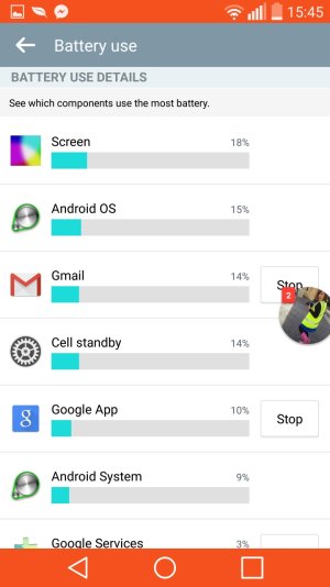

Battery life seriously bad on my G3 please help
I've had the G3 since september last year, battery life has always been pretty good, not great, but good.

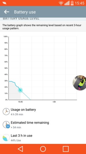

recently though after unplugging it at 6am its flat at 4pm, with little screen on time, maybe 1 or 2 short calls.
I have taken most of my apps off, tried factory resets but it doesn't seem to help. Today After quite a bit of screen on time and taking about 20 photos the phone ran out of battery after about 5 hours!...Screen surprisingly was only just the highest culprit at 18% see screenshots...
Android OS seems to be taking up more and more each day! and as for G-Mail, I only read 2 e-mails, closed the app and cleared it from recents!

It may just be that you need a new battery. Genuine LG ones are available, though its not always easy to be sure that you're getting a genuine one.
Re: Battery life seriously bad on my G3 please help
Turn of sync or just sync for gmail, see how that goes and if that doesnt work factory reset it and see if the battery performance is still underwhelming. If so then a new battery, but i have used mine for about 7 months and its pretty good.

From the screenshot it looks like it's on Lollipop. I suspect it's your Facebook messenger. When I finally decided to install messenger my battery was tanking pretty bad.

Yes, I have been on lollipop since it was released in the UK (end of last year) but the poor battery life has only started about a month ago. I can't believe the battery could be going bad at just over half a year old! but it is still under warranty so if I can't find anything else then I will send it back.
I know FB messenger had a bubble on the screenshot, but I had only used it for 10 mins and it didn't even show on the battery usage apps. That being said I understand it could be churning away in the background so I have uninstalled to see if that has an affect.
