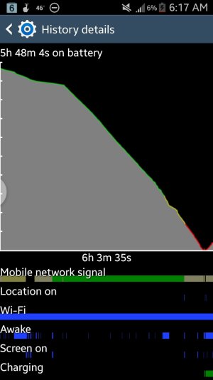

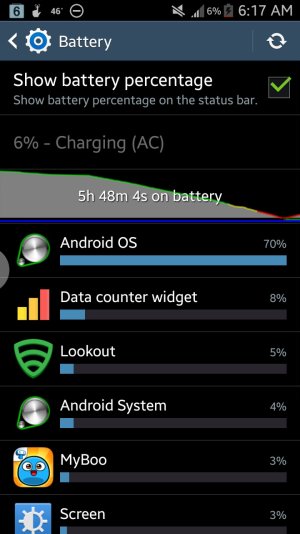

Galaxy S4 Draining From 90 to 0% overnight
My GS4 Drains from 90 to 0 percent overnight because of Android OS. I was planning on doing a factory reset. I am not sure if I should do one though.
Wifi and Mobile data are enabled overnight so that might be one of the reasons.
Specs: Att GS4 on Android 4.4.4, Stock Charger and Battery
Here are some screenshots:

Did you ever get to the bottom of this?
I have exactly the same problem with my s4 running 4.4.2. I go to bed on 100%, wake up to find the battery on single digits, check the battery graph and find during the night it's gone from draining at around 5% an hour to suddenly nose-diving at 20% an hour when not in use.
It doesn't do it all the time, but when I've looked at the stats on GSam, the largest consumption always says Android OS. There's so many processes listed under this heading to make identifying any one reason impossible.
The only app I've heard of that might list the specific reason for the sudden power surge is Wakelock detector, but this doesn't seem to be supported on stock Android.
Do you know of any other app that gives you a more precise breakdown?
