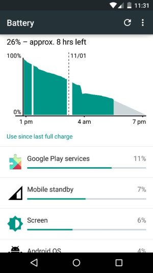

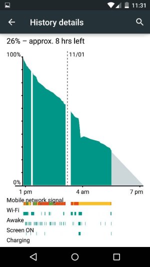

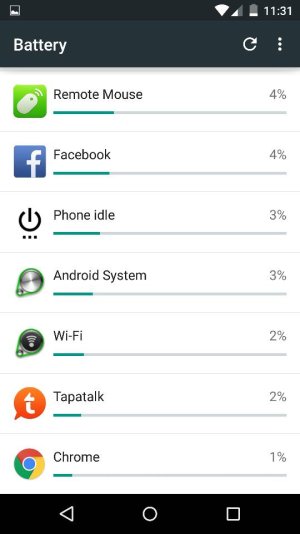

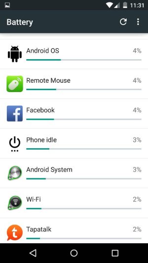

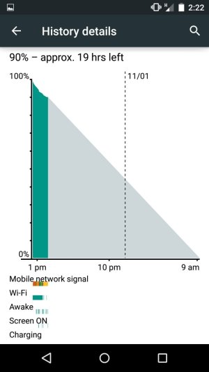

I was at a wedding yesterday so literally barely touched my phone other than turning it off for the service, no pictures no nothing as the camera isn't the best on the nexus. Here is my data at full charge then this morning at 25%, I have the screen really low as well

The first think that I can notice and I'm not an expert is that you don't have a signal at your phone, that its a lot of battery, you can either find a place at night or if you don't care air plane mode, also at night when I'm sleeping I use battery save mode

Hi amanalki
It seems the signal strength is affecting you battery life. It's true that the device doesn't have a great battery in general, but looking at those statistics (check the mobile network signal) I would say the signal is draining your battery.
Have you tried changing default mobile network to 3g? Maybe that could help so it doesn't stay awake looking for signal. You can check that in settings, wireless and networks, mobile networks.

Thanks for the advice, am no expert but I did notice that reading was different to the others but has no idea what it actually meant so thanks for this I will give it a try
