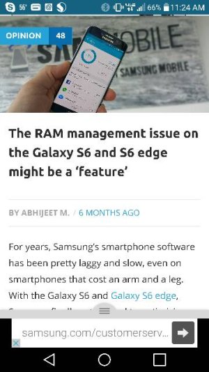

I don't think the case has anything to do with how the phone will perform. The only thing I can think of how the case could affect the performance is if the phone is overheating and the case is keeping the heat in. So I don't think the case is the issue here. The main issue is from the ram management in TouchWiz. TouchWiz is very aggressive with ram and uses between 75% to 90% (estimating) to keep the operating system running smoothly. This leaves you with less than a gigabyte of ram to run everything else smoothly. As you can see in the attached photo this person only has 529mb of free ram. So this is probably the problem with your phone, TouchWiz using up lots of ram leaving you with less than a gig of ram left thus causing slow downs and lag in your phone. I would recommend returning your phone and getting a nexus 6p or an LG v10 if this is a serious problem for you.
Posted via the Android Central App on an LG V10
